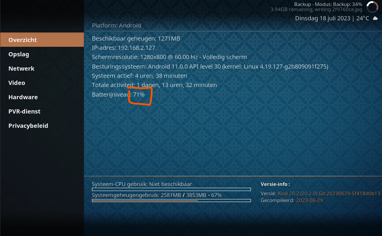

    You could simply use a variable and a boolean condition for that:
    <control type="label">
       <top>-2</top>
       <left>25</left>
       <width>50</width>
       <font>font09</font>
       <align>center</align>
       <label>$INFO[BatteryLevelVar]</label>
       <textcolor>$VAR[BatteryLevelTextColorVar]</textcolor>
     </control>
    Let's check, if the System.BatteryLevel infolabel contains "%"
    <variable name="BatteryLevelVar">
       <value condition="String.Contains(System.BatteryLevel,%)">$INFO[System.BatteryLevel]</value>
    </variable>
    Best. Answer. Ever.
    Edit: After testing, your answer didn't work (tried 'reload.skin()' and 'shutdown()' but no luck ).
    My first guess was "$INFO" should be "$VAR" but this also didn't work.
    I did test the variable by doing:
       <value>$INFO[System.BatteryLevel]</value>
    </variable>
    And the %-indicator shows, so in my guess the line ends up in the right variable but my condition isn't accepted? (also tried without the ",%" but still no luck)
    Thanks (again).
    Okay, great. My English is better and I'm serously doubting the translations when translating back to Dutch or English ... :/ Also my translator adjusts the code when uploading thread :D . Noooo, no no no no no no no (pushed that f*cker away like grandma did in 'Get Out (2017)' :huh:  ^^ :D ;( ).
    One more addition to the Battery Indicator would be great, but I can't seem to find an answer on the Kodi wiki;
    The indicator shows "Busy" when updating library (I presume), a lot. Very noticable on my, bit slower than average, Android device.
    Maybe there is a way to implement text-output "Null" (or space or something) when "Busy" occurs?
    The <progress> bar does this only at startup (0%), and keeps updated after first info-recieve from system, after that the bar stays updated all the time. :thumbup:

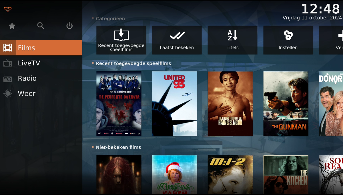

    Today I edited the "Home-hover-settings-info-panel" to fit my needs. Then I noticed that the windows does NOT contain the total-number-of-tvshows, maybe this will be a nice addition in a new release?
    I only added one 'info-line' inside the <label> in ../xml/Home.xml starting at line ~1370 (somewhere in the neighborhood):
    Where "TV Series" should be replace by $LOCALIZED string;
    $INFO[Window(Home).Property(tvshows.Count),, TV Series][CR]
    the [CR] addes one line to the 'label' inside 'control-group'. You probably want to check if this will fit above the texture-shade below because it adds one line (fourth) to that group.
    Mine looks like (I don't care about the watched state, so only two lines)
    Total <control-group> code:
        <top>80</top>
        <label>[B]$INFO[Window(Home).Property(tvshows.Count),, TV Series][CR]$INFO[Window(Home).Property(Episodes.Count),, $LOCALIZE[20453]][/B]</label>
        <font>font12</font>
        <scroll>true</scroll>
    </control>
    I couldn't find the $LOCALIZE-string because I haven't figured out yet where this leads... [bc]

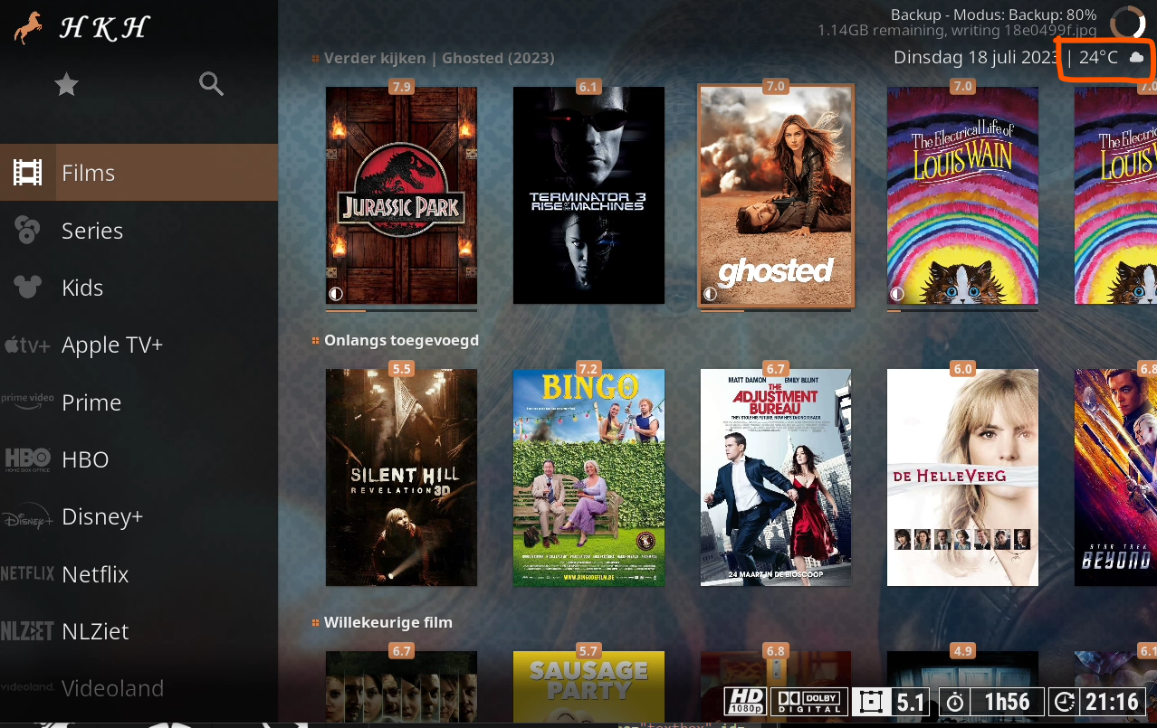

    To finalise the 'Battery Level Indicator' (for me) and make slitely better graphics, especially for clearer view on smaller devices. I made;
    • Added new image .png file (battery_load_full.png) https://pasteboard.co/RrnnJo9lpWGt.png ;
    • Align the <label> indicator to fit right in the middel of the new image;
    • Rescaled the "progress" bar to fit inside the new image;
    • Created a new Variable [BatteryLevelTextColorVar] to also switch the text-color from dark to light (below 30%)
    Edited lines in "Includes.xml" starting at line 2987:
    Edited (extisting) variable in "Variables.xml" starting at line 2041:
    <variable name="BatteryLevelColorVar">
        <value condition="Integer.IsLessOrEqual(System.BatteryLevel,4)">FFEE204D</value>RED
        <value condition="Integer.IsGreater(System.BatteryLevel,4) + Integer.IsLessOrEqual(System.BatteryLevel,6)">FFCD4A4C</value>Mohogany
        <value condition="Integer.IsGreater(System.BatteryLevel,6) + Integer.IsLessOrEqual(System.BatteryLevel,10)">FFE74F00</value>Butternut Squash
        <value condition="Integer.IsGreater(System.BatteryLevel,10) + Integer.IsLessOrEqual(System.BatteryLevel,15)">FFFFCF48</value>Sunglow
        <value condition="Integer.IsGreater(System.BatteryLevel,15) + Integer.IsLessOrEqual(System.BatteryLevel,20)">FFFFFF65</value>Shooting Star
        <value condition="Integer.IsGreater(System.BatteryLevel,20) + Integer.IsLessOrEqual(System.BatteryLevel,90)">FF1CAC78</value>Green
        <value condition="Integer.IsGreater(System.BatteryLevel,90) + Integer.IsLessOrEqual(System.BatteryLevel,100)">FF76FF7A</value>ScreamingGreen
    </variable>
    Added one variable for Text color in "Variables.xml" starting at line 2050:

    And now the indicator (on Android tablet 1280x800px) look like this:
    Or with background on home-screen:

    ...I immediatly altered some code to my own wishes, why?
    1. To NOT use the skin color but solid green, and;
      Because it was confusing when using an orange skin-color.
      And perhaps this is a great option to have in Skin-Settings? See bottom.
    2. To add extra indication (4-stages), RED, ORANGE, GREEN and Screaming GREEN. For when the battery turns 0-10%, 10-20%, 20-80%, 80-100% (See altered code below)
    3. Additional: I looked into 'InfoLabels' but unfortunatly there is no flag for "BatteryCharging"
      (This would make a great addition to Kodi and gives us the oppertunity to add a 'lightning-bolt.png' when charging)
    Altered code (addons/skin.estuary.modv2/xml/Includes.xml) with full 'includes lines' (starting at line 2993)

    I saw these strings "InfoLabels" and tried to make them appear in a textbox but this didnt work. xD
    Thanks again.
    Hi, big fan here. Keep up the good work.
    I'm trying to create a text field on the home screen wich indicates the battery level (like done in 'Settings - System Information - Overview', it works over there). The reason is that I run Kodi (only) on several (mobile) tablets and there is NO battery indication or watchdog in the Android-OS active anymore.
    But I can't seem to find my way 'into the code' properly, yet. I've tried to replicate the weather indications in Home.xml and adding the lines of code from "SettingsSystemInfo.xml" Tried to make it exactly like the 'Estuary MOD v2'-option: "Show weather in top section". I don't fully understand the file-structures and xml references yet...
    Unfortunatly there no battery-image anywere in Textures.xbt so this needs to be added if an icon needs to be displayed.
    It would be awesome if a feature like this was build-in, into the skin. Even better with a ON/OFF switch in Skin-settings, just like the show-weather option.
