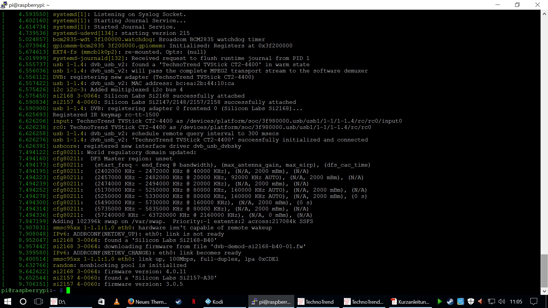

    bin jetzt bei
    Linux raspberrypi 4.9.4-v7+ #949 SMP Mon Jan 16 18:25:36 GMT 2017 armv7l GNU/Linux
    Habe auch TVHeadend nochmals installiert...leider ist das Ergebnis immer noch gleich wie in meinem ertsen Post, nut ein Tuner wird angezeigt...:(
    Aber der Bootvorgang sieht etwas anders aus:
    [ 48.268598] usb 1-1.2: new high-speed USB device number 4 using dwc_otg
    [ 48.399700] usb 1-1.2: New USB device found, idVendor=0b48, idProduct=3014
    [ 48.399716] usb 1-1.2: New USB device strings: Mfr=1, Product=2, SerialNumber=3
    [ 48.399729] usb 1-1.2: Product: TechnoTrend USB-Stick
    [ 48.399739] usb 1-1.2: Manufacturer: CityCom GmbH
    [ 48.399749] usb 1-1.2: SerialNumber: 20131128
    [ 49.748593] usb 1-1.2: dvb_usb_v2: found a 'TechnoTrend TVStick CT2-4400' in warm state
    [ 49.748929] usb 1-1.2: dvb_usb_v2: will pass the complete MPEG2 transport stream to the software demuxer
    [ 49.749020] DVB: registering new adapter (TechnoTrend TVStick CT2-4400)
    [ 49.750343] usb 1-1.2: dvb_usb_v2: MAC address: bc:ea:2b:44:10:ca
    [ 49.773762] i2c i2c-3: Added multiplexed i2c bus 4
    [ 49.773786] si2168 3-0064: Silicon Labs Si2168-B40 successfully identified
    [ 49.773797] si2168 3-0064: firmware version: B 4.0.2
    [ 49.789643] media: Linux media interface: v0.10
    [ 49.796378] si2157 4-0060: Silicon Labs Si2147/2148/2157/2158 successfully attached
    [ 49.796451] usb 1-1.2: DVB: registering adapter 0 frontend 0 (Silicon Labs Si2168)...
    [ 49.848609] Registered IR [definition=10,0][definition='3','0']keymap[/definition][/definition] rc-tt-1500
    [ 49.849368] input: TechnoTrend TVStick CT2-4400 as /devices/platform/soc/http://3f980000.usb/usb1/1-1/1-1.2/rc/rc0/input0
    [ 49.849410] rc rc0: TechnoTrend TVStick CT2-4400 as /devices/platform/soc/http://3f980000.usb/usb1/1-1/1-1.2/rc/rc0
    [ 49.849429] usb 1-1.2: dvb_usb_v2: schedule remote query interval to 300 msecs
    [ 49.849450] usb 1-1.2: dvb_usb_v2: 'TechnoTrend TVStick CT2-4400' successfully initialized and connected
    [ 49.849612] usbcore: registered new interface driver dvb_usb_dvbsky
    [ 49.880721] si2168 3-0064: downloading firmware from file 'dvb-demod-si2168-b40-01.fw'
    [ 50.589003] si2168 3-0064: firmware version: B 4.0.11
    [ 50.602659] si2157 4-0060: found a 'Silicon Labs Si2157-A30'
    [ 50.655412] si2157 4-0060: firmware version: 3.0.5
    Vielleicht hat ja noch einer eine Idee...könnte es an raspbian liegen? Das OS ist mir ja eigentlich egal....werde morgen vielleicht mal libreelec versuchen, wenn es damit vielleicht besser geht.

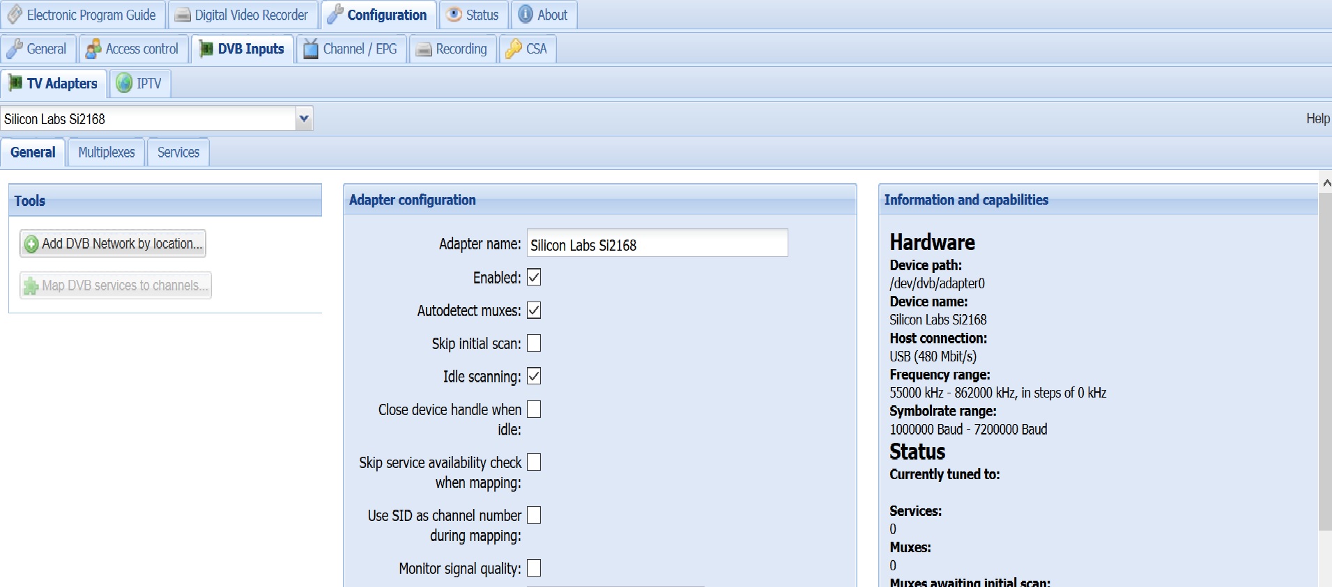

    So, hab jetzt die alte Version (3.4.28) installiert, (siehe Bild) es wird wieder ein Adapter angezeigt, aber zu -T oder -C seh ich hier jetzt nix..
    Habe mal Add Network versucht...da bekomme ich aber nicht wie erwartet KabelBW oder Unitymedia angezeigt....glaube das Problem besteht noch....
    Finde ich irgendwo die Einstellungen für Unitimedia um die Muxe manuell anzulegen?

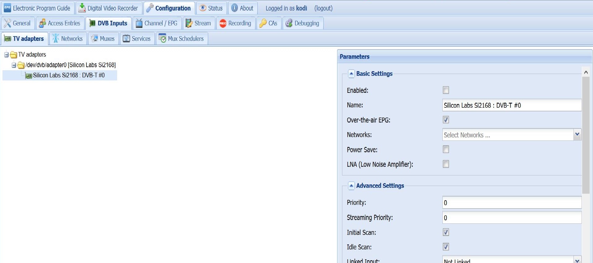

    Hallo Zusammen,
    ich habe mir im letzten Jahr einen HTPC aufgesetzt, und dieses Forum war immer sehr hilfreich.
    Zu meinem aktuellen Problem habe ich im Forum und auch im Netz nichts finden können. Um meinen HTPC mit einem TV Signal zu versorgen, habe ich mir mit einem Pi2 einen TV Server aufgesetzt. Installiert ist Raspbian (Jessie) und TVHeadend. Ich benutze den TV-Stick CT2-4400 (Version2) von TechnoTrend, da dieser hier im Forum auch immer wieder empfohlen wurde. Die Firmware habe ich nach dieser Anleitung eingebunden.
    Jetzt das Problem, in TVHeadend bekomme ich nur einen Tuner angezeigt (siehe Bild) und an diesen kann ich kein Netzwerk vom Typ DVB-C anhängen.
    Ich denke richtig wäre es wenn in TVHeadend 2 Tuner angezeigt werden, oder? Einer DVB-T und einer DVB-C.
    Würde gerne meinen Kabelanschluss von Unitymedia streamen.
    Irgendwie komm ich nicht weiter und weiß auch nicht wo das Problem überhaupt liegen könnte....scheinbar besteht es bei anderen nicht....sondt würde man ja was dazu finden. Anbei auch noch ein Auszug aus dmesg wie der Stick eingebunden wird.
