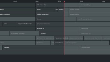

    @L0RE
    I was wrong about the fact that you can not play Swedish Channels live. :(
    In my defense there are two things that confuse me. ?(
    The first one is the fact that there are lots of SVT1 channel icons on the TV Stations Screen.
    (Look at the attached file.)
    One of them is actually the right live one, and it works! :thumbup:
    But, when I go to Mediathek to check which one who should be running now, I see that that the "current" program is not there. :(
    But it is not true. :thumbup:
    In the Mediathek the Swedish channels have the wrong start time :!:
    They are one hour backdated. This confused me for quite a while.
    The program that REALLY started at 19:00 and ended at 20:00 looks like
    it started at 18:00 and ended at 19:00 in the Mediathek.
    Why that is I do not know. ?(
    so,
    It would be good to get rid of the extra icons in TV Channels and
    have the right Start times in the Mediathek.
    /PAD ¤

    v@LORE
    Now it works much better. :thumbup:
    Mediatheke works perfect. Much better than in Magine.
    In The TV Stations screen I think that you just present stuff like magine does itself (please see the picture).
    Typically you come and have missed your program by 10 minutes or so, Would it not be perfect to start that program..
    Often you also want to see when your program starts.
    At least there should be a sorting order of Sender - Time - Sendung which is what you
    normally would want.
    No need for this to be dynamic and move with time though.
    (The backward scrolling can be handled in the future. No need to rush,)
    Another thing I am thinking of is that it looks as if you can change language (German, English, ...)
    but there is no setting to actually set it. Should it not be set there..?
    If you want, I can translate the English section and build a Swedish one and send them to you..?
    /PAD ¤
