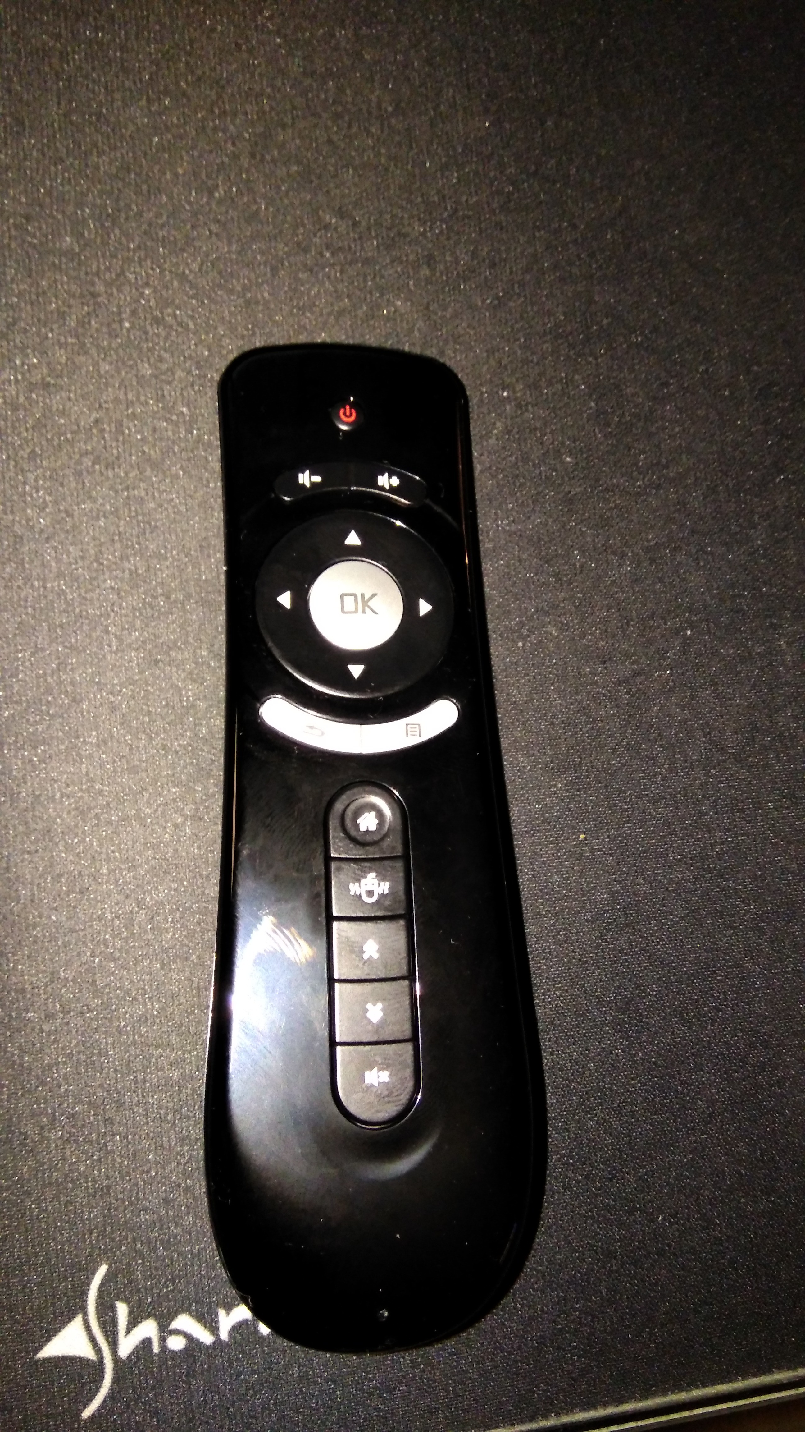

Hi,
ich habe diese Vorlage mal genommen und in den .config Ordner kopiert.
Alles anzeigen#****************************************************************************************** # # this file is configuration for each factory remote device # # factory_code each device has it's unique factory code. # pattern: custom_code(16bit) + index_code(16bit) # examble: 0xff000001 = 0xff00(custom_code) + 0001(index_code) # # work_mode 0 :software mode 1 :hardware mode # repeat_enable 0 :disable repeat 1 :enable repeat # # release_delay unit: ms # release will report from kernel to user layer after this period # of time from press or repeat triggered. # # debug_enable 0 :debug disable 1 :debug disable # # SW MODE: # bit_count how many bits in each frame # tw_leader_act time window for leader active # tw_bit0 time window for bit0 time. # tw_bit1 time window for bit1 time # tw_repeat_leader time window for repeat leader # REG: # reg_base_gen set value for PREG_IR_DEC_BASE_GEN # reg_control set value for PREG_IR_DEC_CONTROL # reg_leader_act set value for PREG_IR_DEC_LEADER_ACTIVE # reg_leader_idle set value for PREG_IR_DEC_LEADER_IDLE # reg_repeat_leader set value for PREG_IR_DEC_REPEAT_IDLE # reg_bit0_time set value for PREG_IR_DEC_BIT0_TIME #****************************************************************************************** #amlogic NEC remote factory_code = 0x7f800001 work_mode = 0 repeat_enable = 1 repeat_delay = 130 repeat_peroid = 120 release_delay = 20 debug_enable = 1 # fn_key_scancode = 0x52 #MOUSE # left_key_scancode = 0x25 #LEFT # right_key_scancode = 0x27 #RIGHT # up_key_scancode = 0x26 #UP # down_key_scancode = 0x28 #DOWN # ok_key_scancode = 0x0d #OK mouse_begin # 0 0x25 #LEFT # 1 0x27 #RIGHT # 2 0x26 #UP # 3 0x28 #DOWN mouse_end key_begin # 0x51 116 #Power # 0x4d 164 #PLAYPAUSE (MUTE) # 0x09 398 #RED # 0x11 399 #GREEN # 0x54 400 #YELLOW # 0x4f 401 #BLUE # 0x56 104 #PAGEUP (VOL-) # 0xbd 168 #REWIND # 0xbb 208 #FASTFORWARD # 0x4e 109 #PAGEDOWN (VOL+) # 0x25 105 #LEFT # 0x27 106 #RIGHT # 0x26 103 #UP # 0x28 108 #DOWN # 0x0d 28 #ENTER (OK) # 0x53 102 #HOME # 0x1b 1 #ESC (BACK) # 0x49 46 #C (CONTEXTMENU) ## 0x52 nn #MOUSE (dont use this line, key is mapped in fn_key_scancode) # 0x30 11 #No.0 # 0x31 2 #No.1 # 0x32 3 #No.2 # 0x33 4 #No.3 # 0x34 5 #No.4 # 0x35 6 #No.5 # 0x36 7 #No.6 # 0x37 8 #No.7 # 0x38 9 #No.8 # 0x39 10 #No.9 # 0x44 14 #BACKSPACE # 0x58 23 #INFO # 0x4d 113 #MUTE # 0x56 114 #VOLUMEDOWN # 0x4e 115 #VOLUMEUP # 0x09 364 #FAVORITES # 0x11 102 #HOME # 0x54 158 #BACK # 0x4f 171 #CONFIG key_end repeat_key_begin repeat_key_end
dann per SSH und den Befehl dmesg -c ausgeführt (Systeminformation werden runter geschrieben) . Dann die Remote eine Taste gedrückt und nochmal dmesg -c und es passiert garnix. -
Derzeit schreibfaul, liegt leider daran das nur mit einer Hand derzeit schreiben kann :-(. Bin ein wenig weiter gekommen, bisher geht die Return und OK Taste noch nicht
Flymote AF106 2.4GHz Wireless Air Mouse with Remote Control Function for Android Windows Linux Mac
- BLACK -
https://www.gearbest.com/mice-...um=ema…mpaign=shipping
, und libreelec Kryhton 17.6.
Die Ok / Enter Taste wird nicht übermittelt, auch unter [definition=10,0][definition='3','0']keymap[/definition][/definition] Editor nicht.
Vielleicht hinüber die Taste?
Ansonsten poste gerne alles an *. XML Dateien dann probiere nach und nach aus!
Zufällig jemand eine funktionierende [definition=10,0][definition='3','0']keymap[/definition][/definition].xml für folgende FB ?
