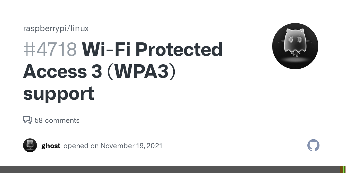

    Die WLAN-Firmware, die derzeit auf dem RPi verwendet wird, unterstützt kein WPA3. Siehe auch diese Problemberichte in den RPi-Repos
    Wi-Fi Protected Access 3 (WPA3) support · Issue #4718 · raspberrypi/linux
    I bought a Raspberry Pi Zero 2 W and apparently it does not support my home wifi which uses WPA3. I excepted that to be the case, since on Debian usually works…
    github.com

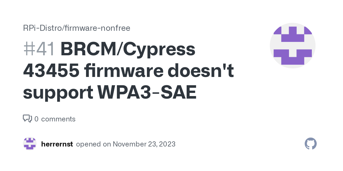

    BRCM/Cypress 43455 firmware doesn't support WPA3-SAE · Issue #41 · RPi-Distro/firmware-nonfree
    At raspberrypi/linux#4718, there's a discussion why internal WiFi doesn't support WPA3-SAE encryption (which is the most secure). Turns out RPi OS ships with…
    github.com
    Wir warten alle darauf, dass die RPi-Leute ihre Firmware-Dateien aktualisieren.
