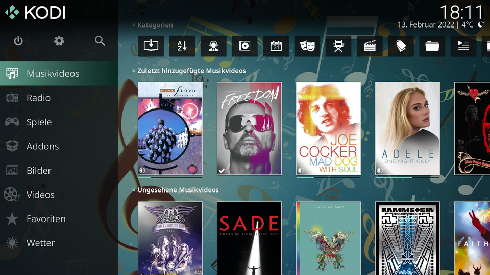

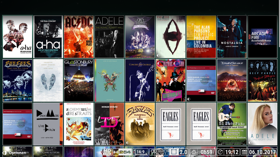

    But I am still struggling to change the main menu. I would like a separate item for my video Concerts (all these files are in a separate directory "Concerts").
    It is easy to create the item in the menu (with label and logo), but I am doing something wrong since nothing appears when I go (or click) to this new item.
    Is there any help (tutorial) available ?
    Thanks in advance.
  • Apply your concert folder to the database and assign as database type "this folder contains music videos" (yes, music videos). Use the tmdb scraper for this folder or - even better - "TMDB Concert Mod" from nerdsrepo. All your concerts will now shown in the menu entry "Music Videos". Simply rename this entry to "Concerts" (Settings -> Skin -> Modify Main Menu) or whatelse suit your needs. That's all.
