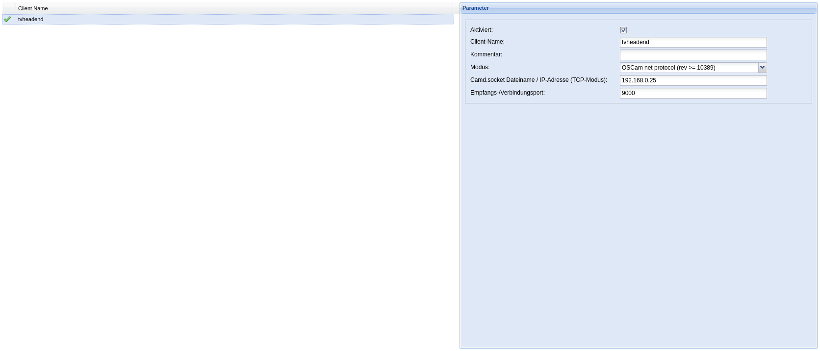

- 2021/06/23 16:57:54 495F7661 c (client) plain dvbapi-client granted (tvheadend, au=auto (1 reader))
- 2021/06/23 16:57:54 495F7661 c (dvbapi) dvbapi channelcache loaded from /config/oscam/oscam.ccache
- 2021/06/23 16:57:54 495F7661 c (dvbapi) Using TCP listen socket, API forced to DVBAPIv3 (0), userconfig boxtype: 11
- 2021/06/23 16:58:50 495F7661 c (dvbapi) Client connected: 'Tvheadend 4.2.8-36~g5bdcfd8ac' (protocol version = 2)

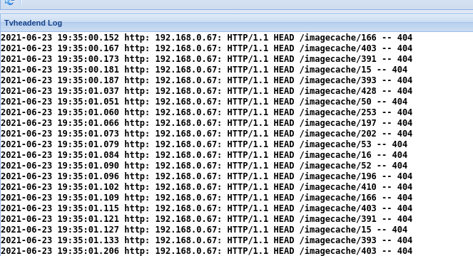

Aber das Log schaut komisch aus
2021-06-23 17:42:20.805 [ NOTICE] START: HTS
Tvheadend version 4.2.8-36~g5bdcfd8ac started, running as PID:329 UID:99
GID:100, CWD:/run/s6/services/tvheadend CNF:/config
2021-06-23 17:42:25.220 [ INFO] htsp: Got connection from 192.168.0.67
2021-06-23 17:42:25.220 [ INFO] htsp: 192.168.0.67: Welcomed client software: Kodi Media Center (HTSPv34)
2021-06-23 17:42:25.224 [ INFO] htsp: 192.168.0.67 [ Kodi Media Center ]: Identified as user 'Kodibaer'
2021-06-23 17:42:25.224 [ INFO] htsp: 192.168.0.67 [ Kodibaer | Kodi Media Center ]: Privileges updated
2021-06-23 17:42:35.959 [ ERROR] http: 192.168.0.67: HTTP/1.1 HEAD /imagecache/391 -- 404
2021-06-23 17:42:35.966 [ ERROR] http: 192.168.0.67: HTTP/1.1 HEAD /imagecache/15 -- 404
2021-06-23 17:42:35.981 [ ERROR] http: 192.168.0.67: HTTP/1.1 HEAD /imagecache/393 -- 404
2021-06-23 17:42:35.993 [ ERROR] http: 192.168.0.67: HTTP/1.1 HEAD /imagecache/428 -- 404
2021-06-23 17:42:36.000 [ ERROR] http: 192.168.0.67: HTTP/1.1 HEAD /imagecache/50 -- 404
2021-06-23 17:42:36.009 [ ERROR] http: 192.168.0.67: HTTP/1.1 HEAD /imagecache/253 -- 404
2021-06-23 17:42:36.016 [ ERROR] http: 192.168.0.67: HTTP/1.1 HEAD /imagecache/197 -- 404
2021-06-23 17:42:36.022 [ ERROR] http: 192.168.0.67: HTTP/1.1 HEAD /imagecache/202 -- 404
2021-06-23 17:42:36.029 [ ERROR] http: 192.168.0.67: HTTP/1.1 HEAD /imagecache/53 -- 404
2021-06-23 17:42:36.035 [ ERROR] http: 192.168.0.67: HTTP/1.1 HEAD /imagecache/16 -- 404
2021-06-23 17:42:36.041 [ ERROR] http: 192.168.0.67: HTTP/1.1 HEAD /imagecache/52 -- 404
2021-06-23 17:42:36.049 [ ERROR] http: 192.168.0.67: HTTP/1.1 HEAD /imagecache/196 -- 404
2021-06-23 17:42:36.073 [ ERROR] http: 192.168.0.67: HTTP/1.1 HEAD /imagecache/410 -- 404
2021-06-23 17:42:36.079 [ ERROR] http: 192.168.0.67: HTTP/1.1 HEAD /imagecache/166 -- 404Wie gesagt ist wirklich nicht mein Lieblingsgebiet.
