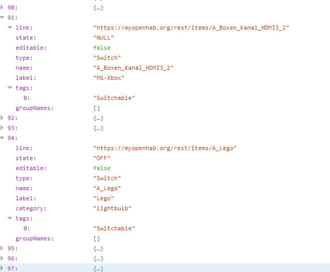

    Im MyOpenHab Cloud unter https://myopenhab.org/rest/items
    wurden auch alle Items mit den entsprechenden Tags angezeigt

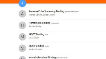

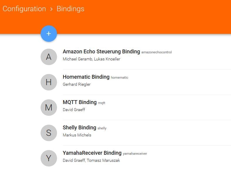

    Installier hatte ich diese Bindings:

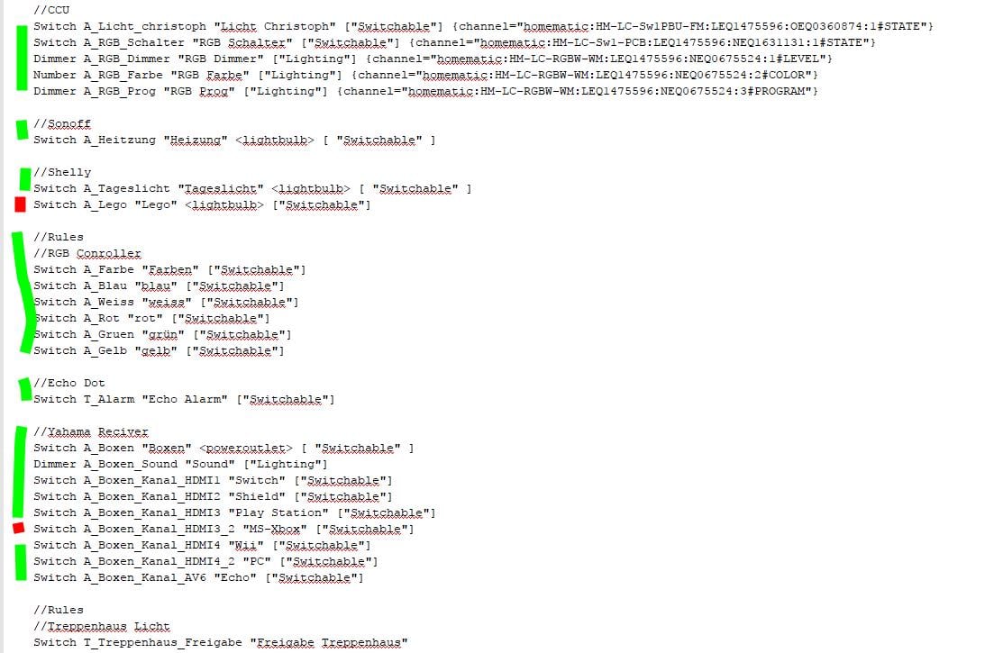

    Ich löschte alle Geräte aus der Alexa App und Passte meine Items an:
    //CCU
    Switch A_Licht_christoph "Licht Christoph" {alexa="Switchable", channel="homematic:HM-LC-Sw1PBU-FM:LEQ1475596:OEQ0360874:1#STATE"}
    Switch A_RGB_Schalter "RGB Schalter" {alexa="Switchable", channel="homematic:HM-LC-Sw1-PCB:LEQ1475596:NEQ1631131:1#STATE"}
    Dimmer A_RGB_Dimmer "RGB Dimmer" {alexa="Lighting", channel="homematic:HM-LC-RGBW-WM:LEQ1475596:NEQ0675524:1#LEVEL"}
    Number A_RGB_Farbe "RGB Farbe" {alexa="Lighting",channel="homematic:HM-LC-RGBW-WM:LEQ1475596:NEQ0675524:2#COLOR"}
    Dimmer A_RGB_Prog "RGB Prog" {alexa="Lighting",channel="homematic:HM-LC-RGBW-WM:LEQ1475596:NEQ0675524:3#PROGRAM"}
    //Sonoff
    Switch A_Heitzung "Heizung" <lightbulb> {alexa="Switchable"}
    //Shelly
    Switch A_Tageslicht "Tageslicht" <lightbulb> {alexa="Switchable"}
    Switch A_Lego "Lego" <lightbulb> {alexa="Switchable"}
    Switch A_Rolladen_g_hoch "Rolladen Groß Hoch" {alexa="Switchable"}
    Switch A_Rolladen_g_runter "Rolladen Groß Runter" {alexa="Switchable"}
    Switch A_Rolladen_g_stopp "Rolladen Groß Stopp" {alexa="Switchable"}
    Switch A_Rolladen_k_hoch "Rolladen Klein Hoch" {alexa="Switchable"}
    Switch A_Rolladen_k_runter "Rolladen Klein Runter" {alexa="Switchable"}
    Switch A_Rolladen_k_stopp "Rolladen Klein Stopp" {alexa="Switchable"}
    //Rules
    //RGB Conroller
    Switch A_Farbe "Farben" {alexa="Switchable"}
    Switch A_Blau "blau" {alexa="Switchable"}
    Switch A_Weiss "weiss" {alexa="Switchable"}
    Switch A_Rot "rot" {alexa="Switchable"}
    Switch A_Gruen "grün" {alexa="Switchable"}
    Switch A_Gelb "gelb" {alexa="Switchable"}
    //Echo Dot
    Switch T_Alarm "Echo Alarm"
    //Yahama Reciver
    Switch A_Boxen "Boxen" <poweroutlet> {alexa="Switchable"}
    Dimmer A_Boxen_Sound "Sound" {alexa="Lighting"}
    Switch A_Boxen_Kanal_HDMI1 "Switch" {alexa="Switchable"}
    Switch A_Boxen_Kanal_HDMI2 "Shield" {alexa="Switchable"}
    Switch A_Boxen_Kanal_HDMI3 "Play Station" {alexa="Switchable"}
    Switch A_Boxen_Kanal_HDMI3_2 "MS-Xbox" {alexa="Switchable"}
    Switch A_Boxen_Kanal_HDMI4 "Wii" {alexa="Switchable"}
    Switch A_Boxen_Kanal_HDMI4_2 "PC" {alexa="Switchable"}
    Switch A_Boxen_Kanal_AV6 "Echo" {alexa="Switchable"}
