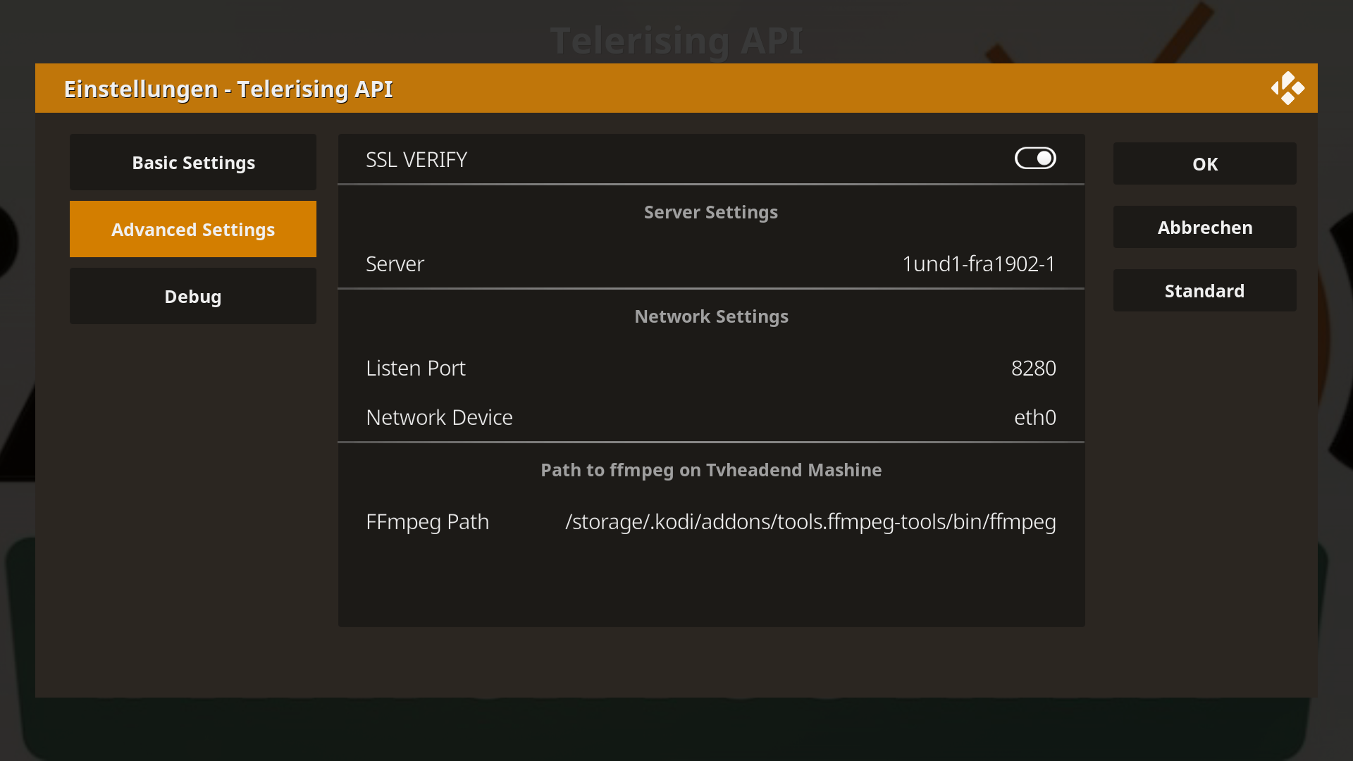

thank you @easy4me,

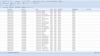

I've changed the configuration as you mentioned, but no change in behavior of tvheadend - no muxes are generated.ffmpeg is installed (version see below) and the path to the binary is changed in the telerisingAPI Kodi-Plugin to /usr/bin/ffmpeg
Alles anzeigenpi@raspberrypi:~ $ ffmpeg -? ffmpeg version 4.1.3-1+rpt1 Copyright (c) 2000-2019 the FFmpeg developers built with gcc 8 (Raspbian 8.3.0-6+rpi1) configuration: --prefix=/usr --extra-version=1+rpt1 --toolchain=hardened --libdir=/usr/lib/arm-linux-gnueabihf --incdir=/usr/include/arm-linux-gnueabihf --arch=arm --enable-gpl --disable-stripping --enable-avresample --disable-filter=resample --enable-avisynth --enable-gnutls --enable-ladspa --enable-libaom --enable-libass --enable-libbluray --enable-libbs2b --enable-libcaca --enable-libcdio --enable-libcodec2 --enable-libflite --enable-libfontconfig --enable-libfreetype --enable-libfribidi --enable-libgme --enable-libgsm --enable-libjack --enable-libmp3lame --enable-libmysofa --enable-libopenjpeg --enable-libopenmpt --enable-libopus --enable-libpulse --enable-librsvg --enable-librubberband --enable-libshine --enable-libsnappy --enable-libsoxr --enable-libspeex --enable-libssh --enable-libtheora --enable-libtwolame --enable-libvidstab --enable-libvorbis --enable-libvpx --enable-libwavpack --enable-libwebp --enable-libx265 --enable-libxml2 --enable-libxvid --enable-libzmq --enable-libzvbi --enable-lv2 --enable-omx --enable-omx-rpi --enable-mmal --enable-openal --enable-opengl --enable-sdl2 --enable-libdc1394 --enable-libdrm --enable-libiec61883 --enable-chromaprint --enable-frei0r --enable-libx264 --arch=armhf --enable-shared libavutil 56. 22.100 / 56. 22.100 libavcodec 58. 35.100 / 58. 35.100 libavformat 58. 20.100 / 58. 20.100 libavdevice 58. 5.100 / 58. 5.100 libavfilter 7. 40.101 / 7. 40.101 libavresample 4. 0. 0 / 4. 0. 0 libswscale 5. 3.100 / 5. 3.100 libswresample 3. 3.100 / 3. 3.100 libpostproc 55. 3.100 / 55. 3.100 Hyper fast Audio and Video encoder usage: ffmpeg [options] [[infile options] -i infile]... {[outfile options] outfile}...
if the new link is tested in the browser it gives an other m3u8 list than before.
Code#EXTM3U #EXTINF:0001 tvg-id="ARD.de" group-title="Main Program" tvg-logo="https://images.zattic.com/logos/2a2a4aee64bbd6f7f817/black/210x120.png", Das Erste HD pipe:///usr/bin/ffmpeg -loglevel fatal -i "http://192.168.178.183:8180/index.m3u8?channel=ard&profile=2" -map 0:0 -map 0:1 -map 0:2 -c:a:0 copy -c:a:1 copy -c:v copy -f mpegts -metadata service_name="Das Erste HD" pipe:1 #EXTINF:0001 tvg-id="ZDF.de" group-title="Main Program" tvg-logo="https://images.zattic.com/logos/42a29350387ee5fda8fe/black/210x120.png", ZDF HD pipe:///usr/bin/ffmpeg -loglevel fatal -i "http://192.168.178.183:8180/index.m3u8?channel=zdf&profile=2" -map 0:0 -map 0:1 -map 0:2 -c:a:0 copy -c:a:1 copy -c:v copy -f mpegts -metadata service_name="ZDF HD" pipe:1 ......
there are also no [definition='1','0']log[/definition] entries in telerisingAPI's [definition='1','0']log[/definition], when pushing "force scan" in tvheadend configuration.
Problem solved after deinstalling tvheadend, purge/remove tvh and .tvh directories, reinstalling tvheadend , reconfigure with startup-config-wizard.

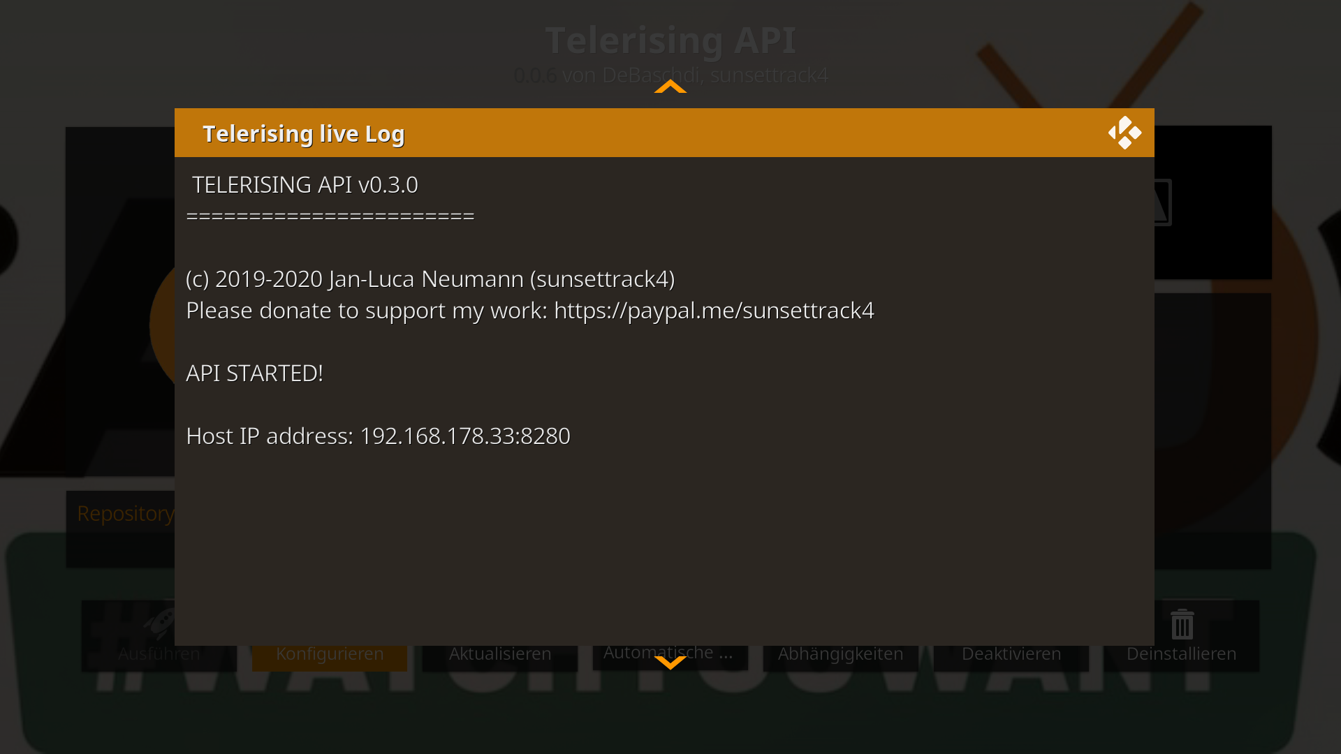

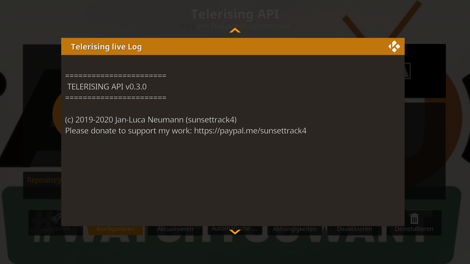

Ich bekomme die URL zur Kanalliste nicht auf die Reihe. Die hier genannten funktionieren nicht, im tvheadend zeigen sich keine Muxes und keine Services. easy4me schreibt in Antwort 20, daß die im Log auftauchen. Kodi / Telerising API / Konfiguration / [definition=12,4][definition='1','3']Debug[/definition][/definition] / Telerising Log / Show live [definition='1','0']log[/definition] zeigt mir eine Fehlermeldung: "Add-on Fehler. Für mehr Informationen, Logdatei einsehen". Welche Logdatei ist denn gemeint, um die URL zu bekommen?
Zur Fehlermeldung im Add-on-Fehler habe ich etwas in der [definition=9,3]Kodi.[definition='1','0']log[/definition][/definition] gefunden:
[errorbox]
19:25:41.510 T:140625427105536 NOTICE: PulseAudio: Opened device Default in pcm mode with Buffersize 150 ms
19:26:07.396 T:140623768151808 WARNING: CPythonInvoker(2): Script invoked without an addon. Adding all addon modules installed to python path as fallback. This behaviour will be removed in future version.
19:26:07.398 T:140623768151808 ERROR: EXCEPTION: Unknown addon id 'service.telerising'.
19:26:07.399 T:140623768151808 ERROR: EXCEPTION Thrown (PythonToCppException) : -->Python callback/script returned the following error<--
Error Type: <type 'exceptions.RuntimeError'>
Error Contents: Unknown addon id 'service.telerising'.
File "/home/scheff3/.kodi/addons/service.telerising/resources/lib/logviewer.py", line 6, in <module>
ADDON = xbmcaddon.Addon(id="service.telerising")
RuntimeError: Unknown addon id 'service.telerising'.
[/errorbox]Was muß ich machen?
