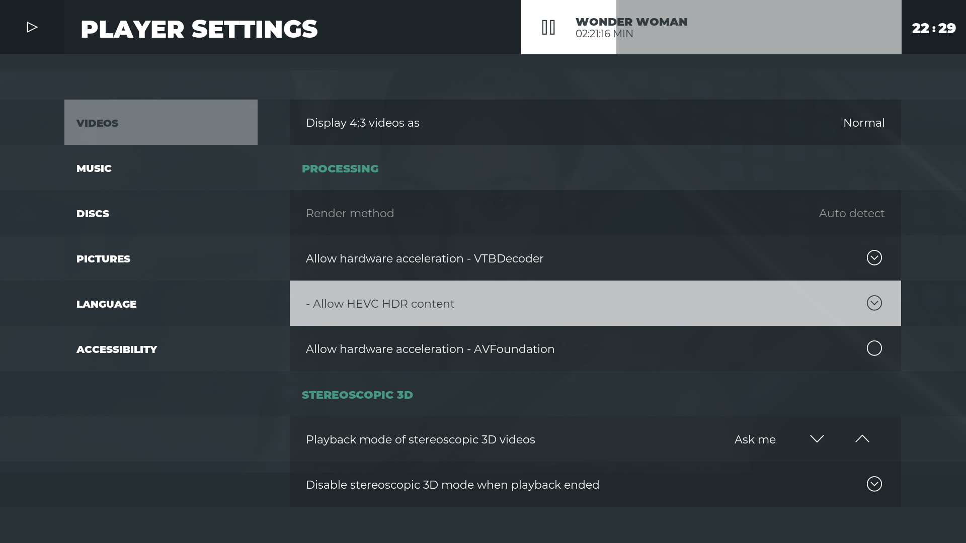

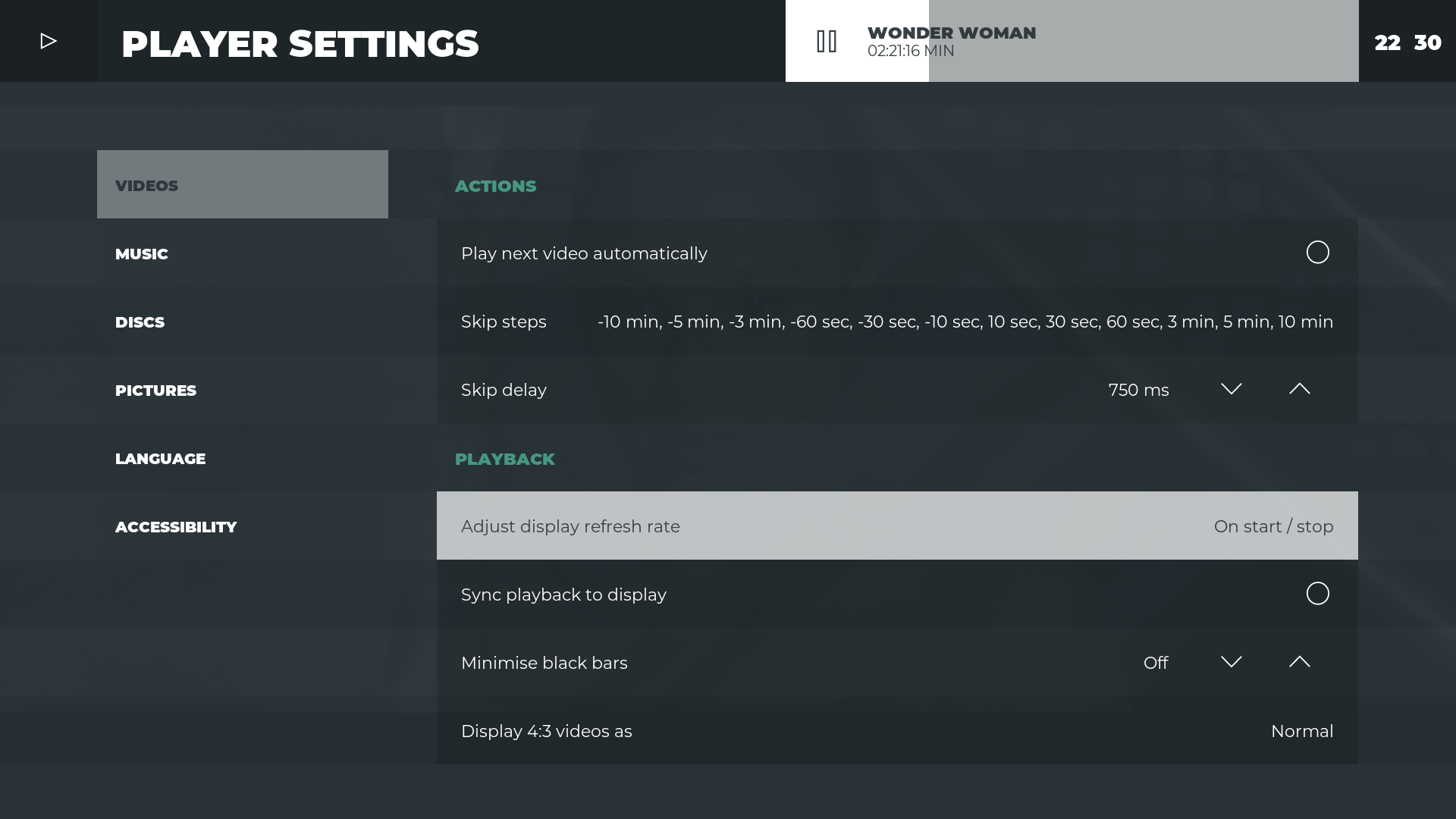

  • Folgende Settings könnten dir behilflich sein:
    System Settings - Display - General - Delay after change of refresh rate - 3.0sec
    Player Settings - Videos - Processing - Allow HEVC HDR content
    Player Settings - Videos - Playback - Adjust display refresh rate - On start / stop
