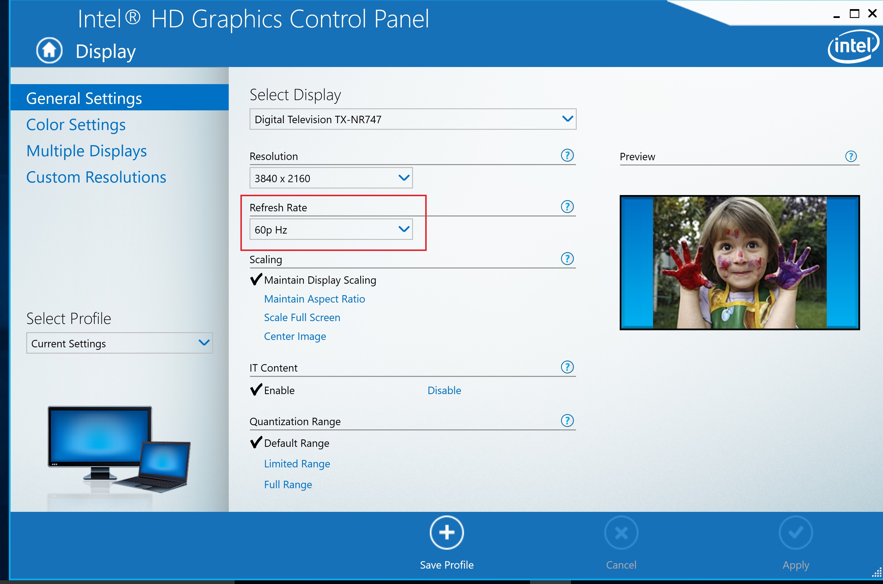

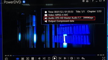

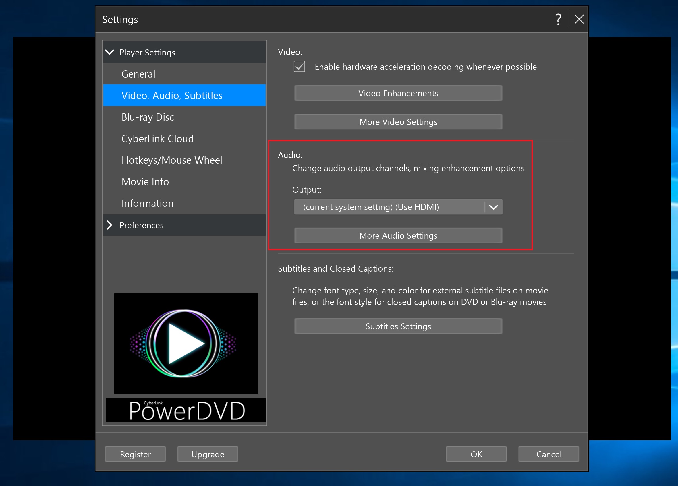

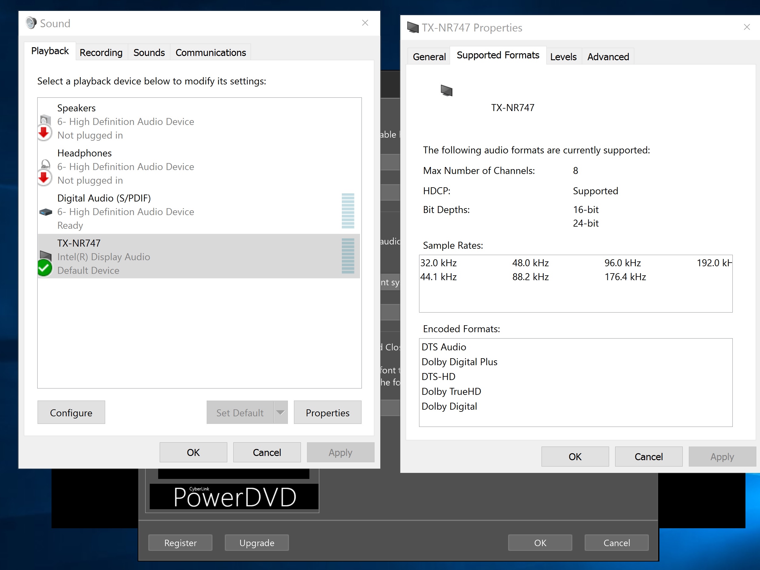

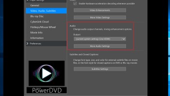

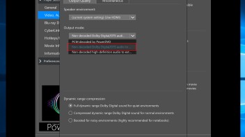

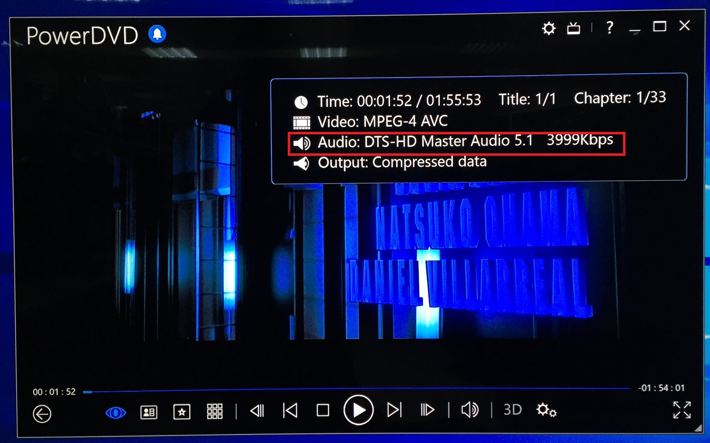

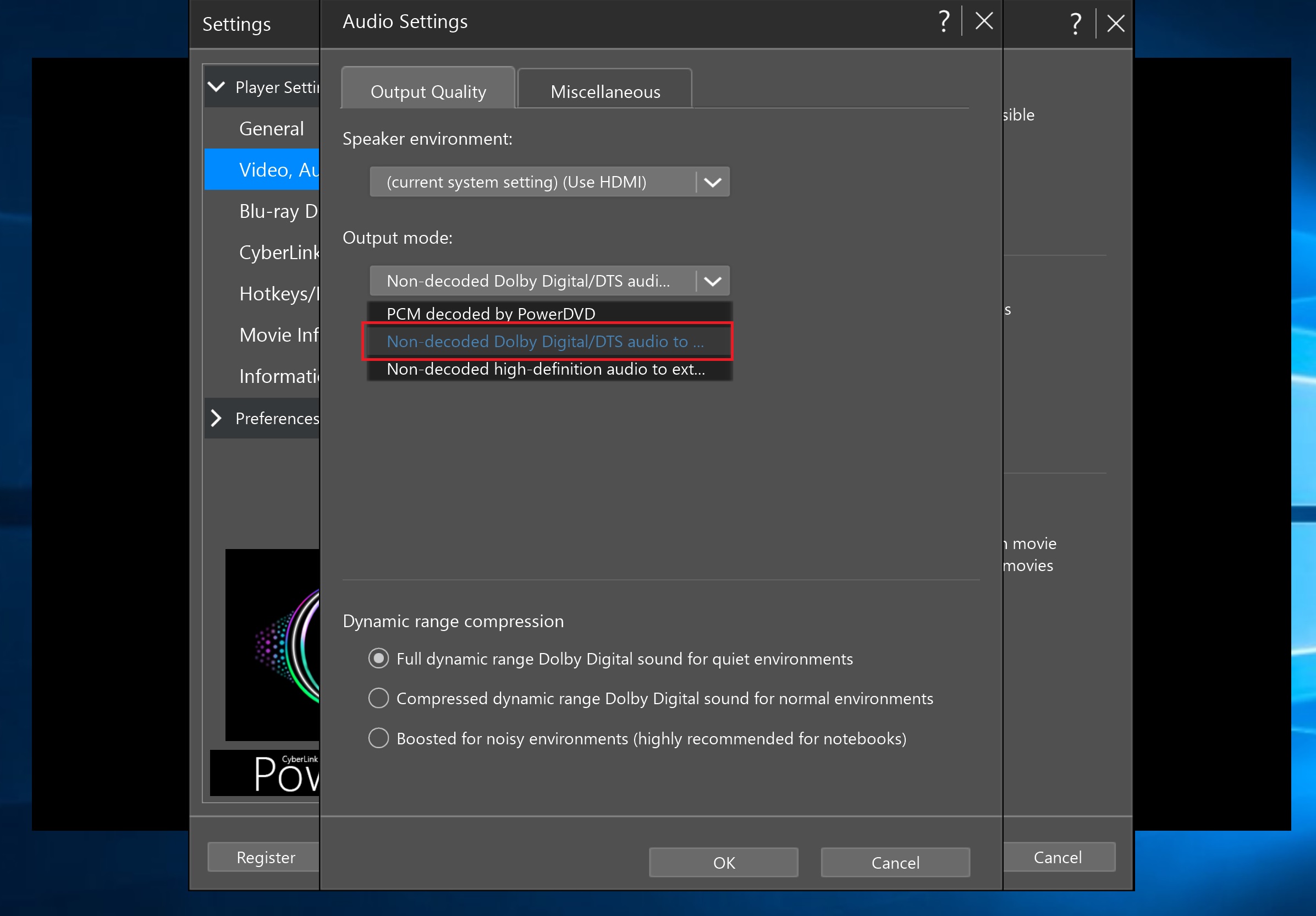

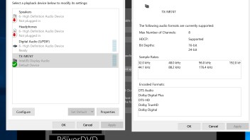

Ich habe eben mit dem Support von ASRock gesprochen und folgenden Lösungsvorschlag erhalten:
Zitat von ASRock SupportWe have tested DTS-HD HDMI 2.0 function using ONKYO TX-NR747 receiver, SAMSUNG UA55KS7000W TV and PowerDVD16 with BIOS P1.10 under Win 10 and the VGA driver ver:4494 could enable this function successfully.
And now we test the same function again with the same BIOS version under Win 10 but the VGA driver is ver:4551 could also enable this function.
To enable the DTS-HD function, the memory should run up to DDR3-1600 with dual channel and at least 4GB for system memory.
Please follow below steps to enable DTS-HD function:
1. Please make sure the driver listed in Device Manager are installed successfully and the VGA version is 4551. (attached DTS-HD_5)
2. Please select Refresh Rate to 60p Hz for supporting HDMI 2.0. (attached DTS-HD_4)
3. Please select the receiver and make sure it supports DTS-HD function. (attached DTS-HD_3)
4. Please select audio field and click More Audio Settings. (attached DTS-HD_1)
5. Please select Output mode to Non decoded Dolby Digital/DTS audio to... option and press OK.
After below setting, it could enable the function successfully. (attached DTS-HD_6)
Die Bilder vom Support habe ich mal mit angehangen. Bei mir hat es übrigens nicht funktioniert, aber vielleicht hilft es dem einen oder anderen zu einem späteren Zeitpunkt.
