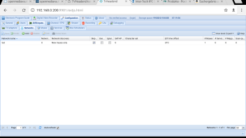

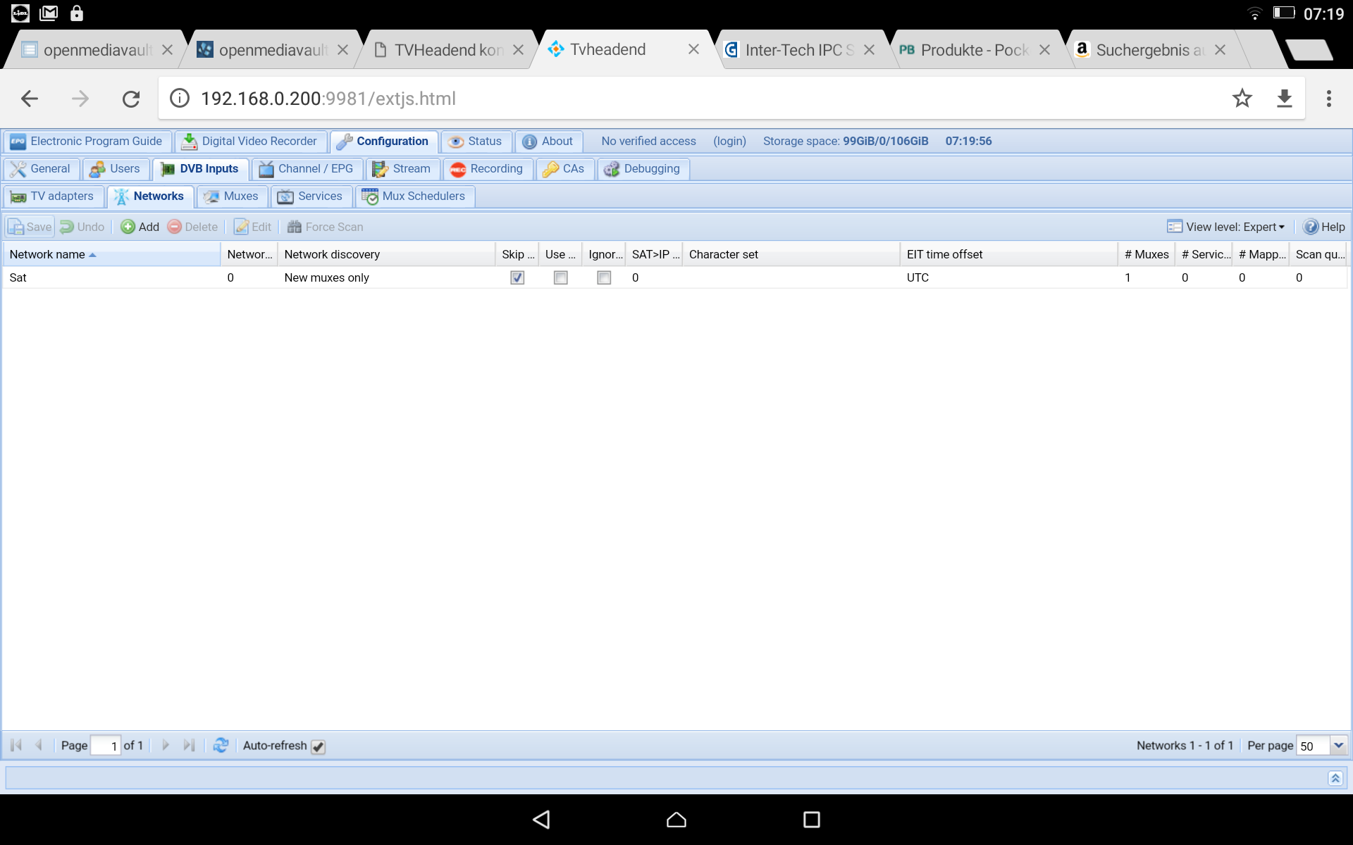

  • Hallo
    die richtige Version ist schon drauf ,Karte erkannt.
    Aber keine Sender ,er scannt einfach nicht.
    wget https://github.com/LibreELEC/dvb-…od-m88ds3103.fw
    root@openmediavault2:~# dmesg | grep DVB
    [ 13.642614] usb 1-4: dvb_usb_v2: found a 'DVBSky S960/S860' in warm state
    [ 13.642715] DVB: registering new adapter (DVBSky S960/S860)
    [ 13.754728] usb 1-4: DVB: registering adapter 0 frontend 0 (Montage Technolog y M88DS3103)...
    [ 13.790893] input: DVBSky S960/S860 as /devices/pci0000:00/0000:00:14.0/usb1/ 1-4/rc/rc0/input21
    [ 13.791036] rc rc0: DVBSky S960/S860 as /devices/pci0000:00/0000:00:14.0/usb1/1-4/rc/rc0
    [ 13.791047] usb 1-4: dvb_usb_v2: 'DVBSky S960/S860' successfully initialized and connected
    [ 25.320920] usb 1-4: DVB: adapter 0 frontend 0 frequency 0 out of range (9500 00..2150000)
